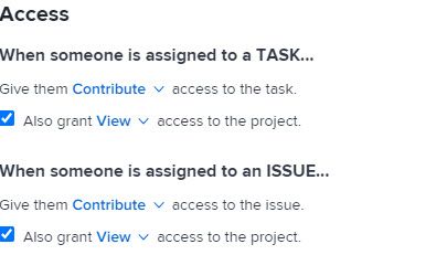

Until you get the Fusion answer, you could edit the project access defaults as shown below. The edit can be made in bulk. Apologies if you already know that. :) ~Jeff
Thanks Jeff! We do have our templates set up for project access defaults to give manage access to the task when someone is assigned. For our business process we need to assign some people with manage and others with contribute access.

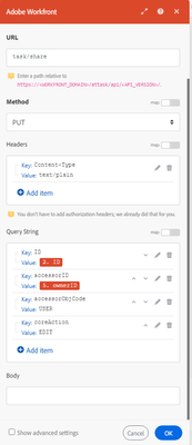

Hi Kato,
Yes, you can use Fusion to trigger updates to an object's security settings. The two screenshots below show a sample from our environment that trigger the automatic update of the Sharing settings on the Portfolio object to grant Manage to a particular Group.
The query string below contains:
  1. The ID of the portfolio record to be updated (in our use-case, an earlier module in this scenario auto-creates that Portfolio object)
  2. The new security setting needed (Manage, Contribute)
  3. What kind of object you're sharing to (Group, Team, Company)
  4. The ID of that object as the 'accessorID'.

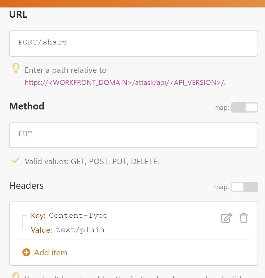

When I try to run the custom API call to PORT/share or OPTASK/share and provide the key:value pairs following your example, I get an error 'accessorObjCode cannot be null'. I tried this with a group and a user, and received the same error message in both cases.
I'm using the default version of the API. Is it possible you are using an earlier version?
I haven't explicitly selected an API version, though if I check Advanced Settings to see that info, it seems to indicate it's using API 11? Give that a try and see if it works for you.
If not, can you show screenshots of your setup?

This one works for me, task sharing example.
