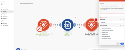

Hi Fusion Community,
I'm looking to update a large number of template tasks with job roles.  All of these updates are for many roles per task.
Is this possible to do via Fusion?  I haven't had success with Kickstarts and have been working with Support on it, but curious if this can be done using Fusion instead?
I set up a scenario for this as follows:
  • Download document module to kick things off
  • Parse CSV to separate out the columns/fields within my CSV file
  • Update record module.
    • For the Record Type field, I was thinking of using the 'Assignment' object, but I can't seem to get a list of assignment ID's from template tasks - at least not from frontend reporting.
    • I then thought maybe I'll use the 'Template Task' Record Type, but it only allows you to map to the 'Assigned To ID' field, which is the primary assignee.  I have many assignees I need to assign to individual tasks.
Thoughts?  Ideas?
Nick
