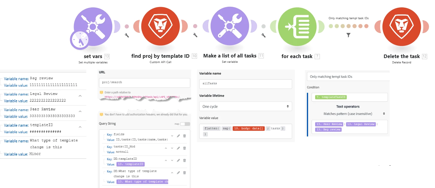

Here is what I would do:
  • Use templateID and templateTaskIDs to identify the respective projects/tasks
  • Set the vars up front
  • Search for projects and include the tasks collection, specify ID and templateTaskID
  • make a list of all the found tasks
  • iterate through the list and filter by one of the taskIDs
  • delete task

Hi @amazingjameso
  • delete task

Ah yes - even easier!
then you don't need the template ID, just the template Task IDs (safer in case someone changes the task names)
Yes WatchEvents module there DE:SpecialField = changed and has that value you seek.
