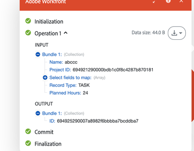

Updating task planned hour through fusion issue
It is not updating the task planned hour

@Lawson02
Bro, could you please tell me why the fusion  through planned hour field it is not updating?
And when we are using "work" to update.The task duration is not updated automatically.
Level 8
Try updating all of these except for task constraint. Play around with these as the locked variables change different aspects of how duration is calculated via hours. I have had trouble with Duration and Planned Hours in the past, they are very frustrating to work with. Submitting a support ticket is a solid way to fix these problems and clear any confusion.
