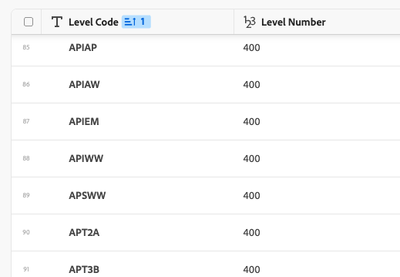

I am trying to search for records in Workfront planning - I have a table where one of the columns is a number field that contains either 100, 200, 300, or 400. Every time I run the search record module to get all records that have 400 as the value, I always get zero results.
Is there any specific way to search records based on number fields?
I tried changing the filter condition - zero bundles regardless of the selection
I tried using just 400, and parseNumber(400:,) - also zero bundles
There is data for that filter condition, so I am at a loss as to why I can't get the search to work.
