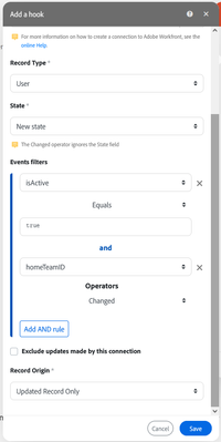

I've got a Workfront webhook as the first module of a Fusion scenario. The scenario is meant to run when the Home Team of an active Workfront user is updated - but it's not working.
Here's how it's configured:
Record type: User
State: New state
Filters:
        HomeTeamID Changed
        AND IsActive EQUAL true
AND connection updates included
Record Origin: Updated Record Only
When I update an active user's Home Team, the webhook is not called so the scenario does not run.
I did some testing and figured that the issue is caused by the filter IsActive EQUAL true.
If I create a webhook withouth that filter, it just works fine. (Obviously it is also called when an inactive user's Home Team is updated - which is not what I want.)
Record type: User
State: New state
Filters:
        HomeTeamID Changed
 Can someone please tell me what is wrong with this filter?
Thank you,
Tibor

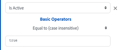

Hi @tibormolnar
I'm no expert at Fusion, but I have run into this before and user "Equal to (case insensitive)" and had it work.
Hi @Alex_Di ,
thank you for the response. However, it seems that the "Equal to (case insensitive)" operator option isn't available for isActive in a webhook config:
So, I tried both IsActive EQUAL TRUE and IsActive EQUAL True, but neither of these work.

Hi @SuryaLakhani,
thank you for the idea. It sounds reasonable but unfortunately, it doesn't work either. I tested it.
The webhook is not triggered when I update an active user.
This has been raised with Adobe. I will post here when I receive their feedback.
