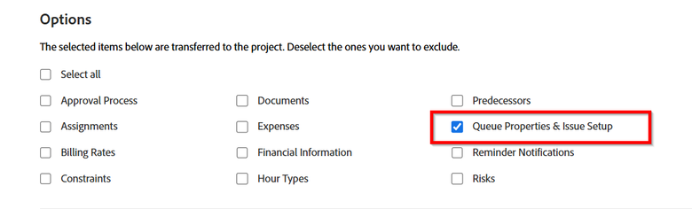

I want to select only 'Queue Properties & Issue Setup' when attaching the project template using Fusion.
What should I enter in the 'Options' field in the Fusion module?

Here is the solution from support:
You’ll need to send the clear parameters for each option, as you're excluding them (except for Queue Properties & Issue Setup)
Each of the following options should be included in the options array:
"options": [
"clearApprovers",
"clearAssignments",
"clearBillingRates",
"clearConstraints",
"clearDocuments",
"clearExpenses",
"clearFinancials",
"clearHourTypes",
"clearPredecessors",
"clearTimedNotifications",
"clearRisks",
"clearSharingOptions"
You could add them this way:
In the future, if you want to exclude Queue Properties & Issue Setup, the correct parameter to use is: "clearIssueSetup"

Hello @Kurt_Jones, This is an existing project. I have created new queue topics that I want to add to over 100 existing projects without modifying anything else. If it is not possible to select only 'Queue Properties & Issue Setup', I can create a new template with only the new queue topics and leave everything else blank, but that would be my last resort.
Hi @_Manish_Singh
I have done this many times before. Just create a new template, blank out as much as you can, then only add the queue topics. If the values are blank on the template, it doesn't wipe out values on the project it's being attached to, it just doesn't update them.
