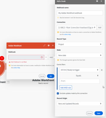

I’m not seeing the custom field in the filter between the two modules - see below:
That said, I do see some options when setting up the webhook in the Watch Events module (I also set my Record Origin to include new and updated records)
After setting this up, I switched my scenario to "ON" and ran a test by setting "Ready to trigger" to "Start" in the project, but nothing happened....

Can you send a snap shot of your customer field  "Ready to Trigger"?
Have you triggered the webhook yet? The webhook has to be triggered, with data in the fields you want, for Fusion to pickup what fields to make available to use in the rest of the scenario.
Also, if you include your filter in the webhook configuration as you have shown in your image, you don't need to repeat your filter. One addition I would recommend to your webhook filtering, though, is to add "DE:{blurred} Ready to start" CHANGED. The way you have it now, every time anything on your object changes, as long as the ready to start field is set to Start, you're going to get a message to the webhook. If you add the CHANGED criteria, it will only get notified when someone changes that specific field, which from your description is what it sounds like you need.
Quick update -  thanks for the help!
I managed to get it working. The issue was with the checkbox that says something like "exclude the action done by the user". Once unchecked, the data arrives to the Fusion scenario as expected.
All sorted now!
