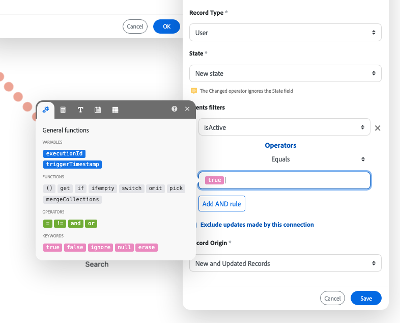

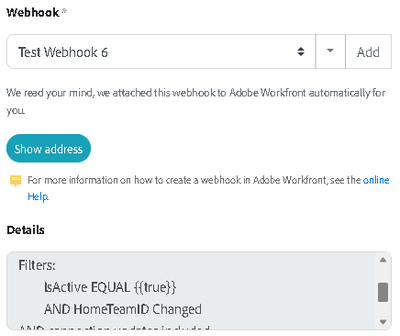

Can you try using "true" from keywords in General functions? What I had noticed in the past is that when you type 'true' or 'false', it sends it as a text, whereas a keyword is sent as a boolean. While they both work the same in the regular search module, a webhook might be more sensitive.
Hi @SuryaLakhani,
thank you for the idea. It sounds reasonable but unfortunately, it doesn't work either. I tested it.
The webhook is not triggered when I update an active user.
