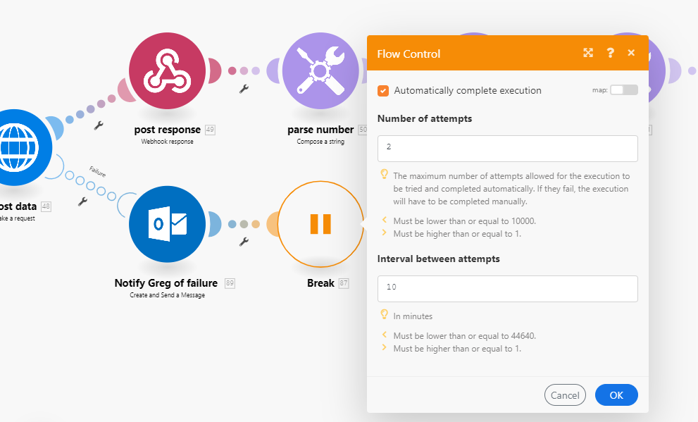

@Todd Crenshaw‚ Thanks for asking. ‚ thanks for answering - not at all as intuitive! Can you advise if using a break will the notification trigger on each attempt or will it only trigger if failed after all defined attempts?
Well so far I've not had an error so no notification has been sent, but also, this means the scenario has processed 3000+ records and I didn't get email bombed. I'm guessing it'll only send when the error occurs, which of course is what I want it to do.
