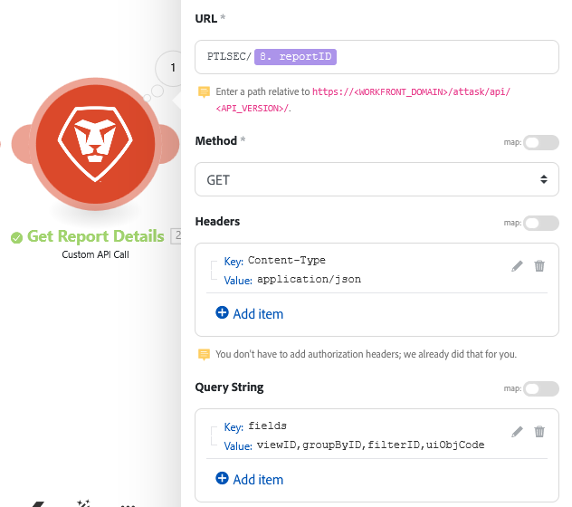

1) Create your report in Workfront first. Then get the report ID (easiest from the URL in WF). Then obtain the viewID, groupByID (if any) & filterID (if any). I did this with a Workfront Custom API call module in Fusion:
Mind the "fields" parameter. (You could also do fields=*)

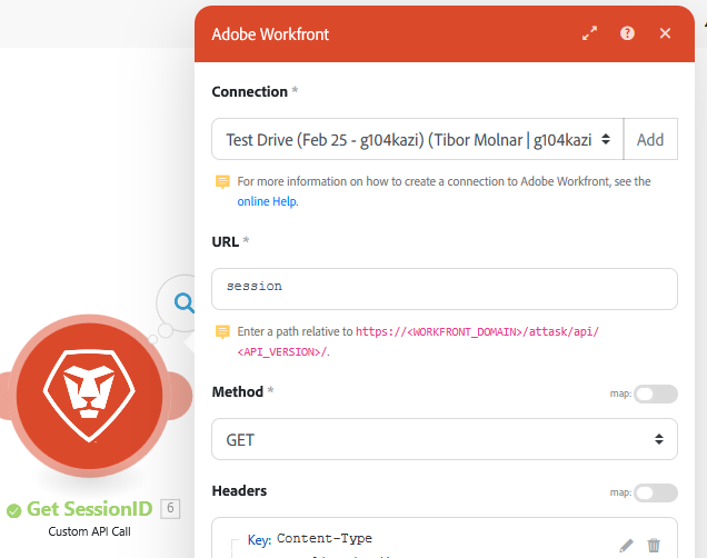

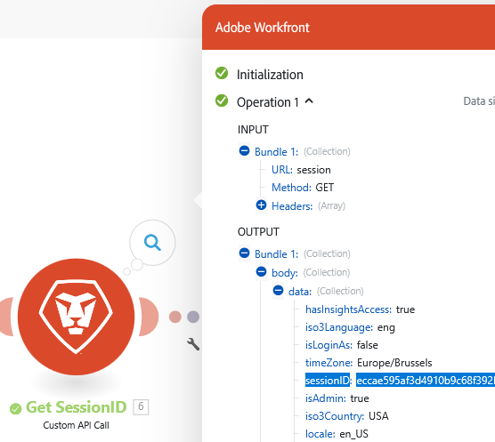

3. For the HTTP module to work, you need to send a sessionID in the header. To get a valid sessionID, run another Workfront Custom API call module first:
The response body contains the sessionID that you need:

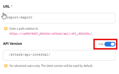

  7. I understand the concept of the "API Path Override" option in the Custom API Workfront module, but I can't make it work. No matter what I put in that field, the versioned API is called. - Could you share the proper syntax, please?
Thank you,
Tibor
Hi @tibormolnar
Apologies - I don't have more in-depth knowledge - as you describe, I got what I shared by looking at the DevTools when downloading a report in Workfront. So - no extra docs, sadly. I would expect the download file to be around for a few minutes, but again, I don't know 😞
api-unsupported = api-internal. Unsupported because they may add/remove/change that API wheras vXX.X is static. The internal API can show features that are not yet available on the public API. I try to avoid relying on that as much as I can.
Try this in the customAPI module
I misunderstood you first, I thought that I need to use "API Path override" if I want to use the Workfront Custom API call module to generate the export file.
Now it is clear that I need to map the API version.
Thank you!
