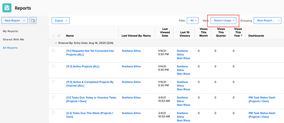

Question #2: Do you have any best practices for cleaning up Reports and Dashboards? Such as reports that are duplicated, are not being used in a dashboard or have not been looked at in over a year.
In Workfront, there is a built-in view in the Reports area called "Report Usage" that you should absolutely leverage as a starting point for cleanup. This view will provide insight into the recent views, dashboard(s) it is associated with, and more - see screenshot.
In terms of looking for duplicate reports, try searching for reports with similar names or keywords in the report title. Or run a "Report Report" to get a full list of reports to see the object type, description, and report name.
Reports are oftentimes created and never used, so remember that not everyone needs access to creating reports. Chances are, the reports they are building already exist and maybe just a need a few tweaks or added columns. Adjust access levels as needed or implement a formal process for requesting reports to try and help alleviate any duplicates!

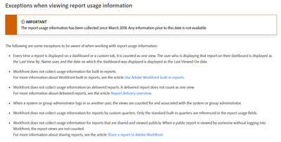

Hello - I am finding some gaps with the Report usage numbers that are provided.  I understand from reviewing the docs that there are some exceptions, but the things I am noticing don't seem to fall into these categories.
For example, if I navigate directly to a report via a "Pin" or by using Search, report usage stats are not updated for that report. I would expect report usage stats to update if I accessed the report directly through a "Pin", Search, or even a link that someone sent to me.  Or are Usage Stats not necessarily real-time?
The only time I observed the usage stats get updated is if I navigate to the report on a dashboard. This is included in the Exceptions in the online doc.  It's odd that this is the only time I see the report usage number increase.  To add to the "strange-factor", usage stats DO NOT increase for the 2nd report on my dashboard.
If there are some other factors at play it, it would be nice if there were more info about that in the documentation or am I overlooking some additional docs?  Tks!

Just a reminder that Workfront counts one view per user per day. If you access the same report several times a day, it is only counted as one view.
I read through the documentation, View Report Usage and tested out each of your concerns in my personal Workfront instance. Below are my findings:
  • Report usage numbers not updating when using Pins - I was able to replicate this same behavior in my personal instance. As the documentation does not state anything about pins in the exceptions area, this is something that needs to be addressed. Please submit a Support Case for this.
  • Report usage numbers not updating when accessed via Search - I was able to replicate this same behavior in my personal instance. As the documentation does not state anything about search in the exceptions area, this is something that needs to be addressed. Please submit a Support Case for this.
  • Report usage numbers not updating when report is accessed via a link - this is expected behavior, per the documentationWorkfront does not collect usage information on delivered reports. A delivered report does not count as one view.
  • Report usage numbers not updating when report is second on a dashboard - I was not able to replicate this behavior. Keep in mind, if you accessed this report earlier in the day (maybe on a different dashboard) then this will not count as a view. If this is not the case for you, I encourage you to submit a case into Customer Support.
If you have any other questions, just let me know. Happy to help!
I've shared this feedback with the Reporting Project Managers, however, the fastest escalation comes from a Customer Support case!
