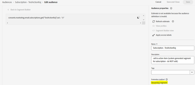

Hi Everyone, we can create the subscription list which will automatically comes to audience list. When we see that audience, we can see streaming segment. Will that comes under 500 guardrail limit. please find the below sample screenshot for the same.

@SatheeskannaK thanks for your reply, is this applicable for subscription list also? Because, subscription list are created automatically from the system perspective. so, how many subscription list, we can create in total.
There's no limitation on the maximum number of subscription lists you can have.
For example, if we create with the below setup, will that allow the system.
streaming audience from regular segment builder ui =500
Subscription list created = 200
Will that add up as sandbox 500 limitation or will that not consider that streaming segment count with regular segment builder audience?
you responded with no limit already, just to confirm whether subscription list aslo comes under the regular streaming audience.guadrail
Unless otherwise, if you use the subscription list created while setting up the audience, it will not count towards the 500 limit.
