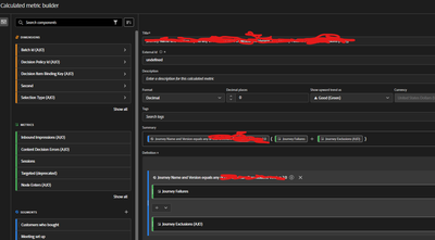

@SatheeskannaK
AJO>configuration>reports section, can we not able to add a new transaction datasets?
It seems interesting... have not used that yet
@Michael_Soprano @gengaipandi03 Yes, this can be used. There are some prerequisites to be met to use the additional datasets for reporting.
https://experienceleague.adobe.com/en/docs/journey-optimizer/using/reporting/channel-report/reportin....
Thanks, Sathees
