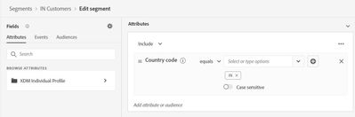

Segment details:
Segment Name: IN Customers
Criteria: HomeAddress-->CountryCode eq "IN"
Journey Details
Journey Name: POCsegmentqualification
We are able to see data in segment
