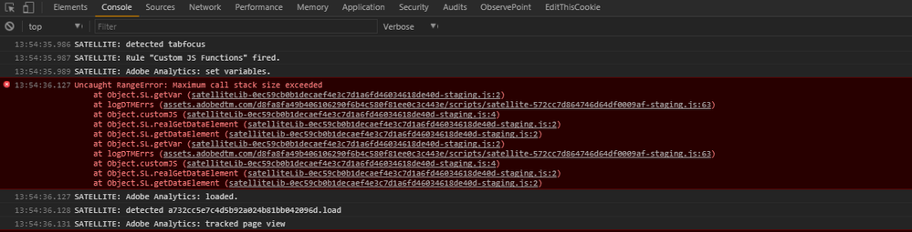

I seem to randomly get this error in the console and of course nothing fires. It seems to only happen on the first request into _satelitte and occurs on the getVar() function.
I cannot duplicate so unfortunately can't trace or set break points
Anyone else experience this or have an idea as to cause?

It looks like this error can be caused by a number of JavaScript errors.
Internally, we've seen that error when the doPlugins runs more than once before a tag fires. Sometimes if two tags fire immediately one after another, we've also seen it. Could either of these situations be true for your site?

Just happened again on first page in session, console screen shot attached. Reload page and all is good
Thnx

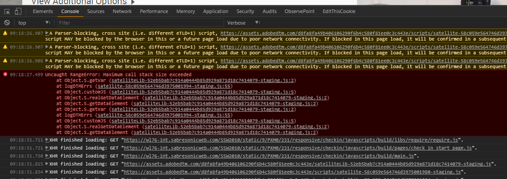

And just got another one on first page reload. But it does not happen on every first page
If you want you can try to replicate here, seems to be happen more frequently
I’ll have to pour through the code to see. At least it seems to only occur on the first hit for a session so that limits the rules, data elements and events I need to look through
