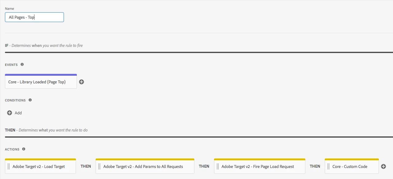

I am currently trying to set-up an Adobe Target demo on a local AEM 6.4 instance. I integrated AEM with Target using Adobe Launch and currently have it set-up with the following rules:
