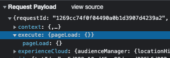

I am trying to push mbox parameter for page load requests as per below doc but I am unable to
see them in Network tab of the developer console. Any suggestions on why this is happening?

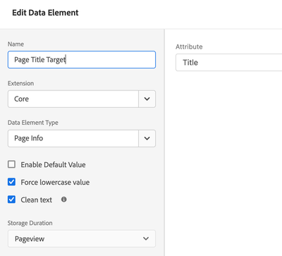

Creating a data element using a javascript variable didn't work for me so I tried changing it to below & it some how worked for me. Rest stays the same. I just mapped my page variable to this data element it gets attached in target calls

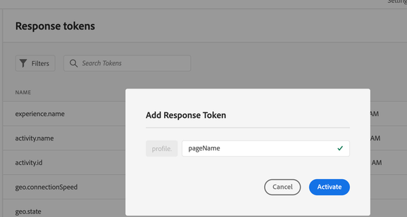

if you use the targetPageParams function accordingly (before the initialisation of adobe target) - then you still have to activate the desired profile parameters under Administration > Response tokens - so that it is also visible in the requests in the dev tools.

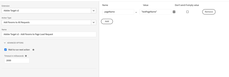

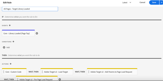

Thanks @Perrin_Ennen in my target library load rule as below screenshot1, I am trying to pass dummy page param like secreenshot2
screenshot2
Does this parameter name need to be activated like below screenshot3:
Hi @JyotiSharmaV,

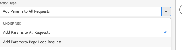

do you have another screenshot of the data element? You can also enter "testPageName" at value for testing - to see if this works then. If this still doesn't work - I would recommend to change the Action Type and also use Add Params to All Requests - if this is currently your problem.

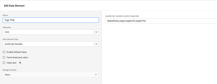

Hi @Perrin_Ennen sorry for replying late. But I am still having issues:
Here is the screenshot for the data element you asked for. This data element is working perfectly okay for all my other rules of analytics so no worry about this.
However, I also tried your way of passing hardcoded value in both action types as you suggested. But nothing is coming up in Request Payload
