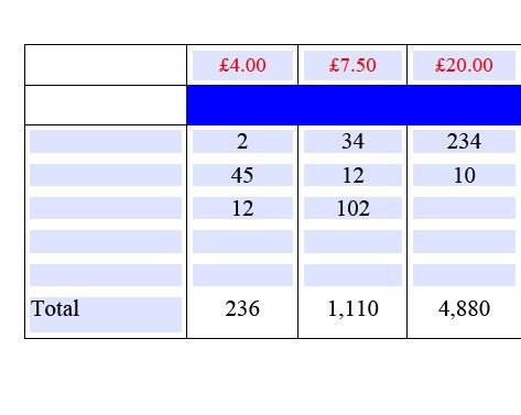

I have created a form with 12 Columns and 23 fixed rows. In Row 1 of the table is a value, the remaining 22 rows allow the user to enter a number, what I would like to do is in the footer row be able to add up the numbers in the 22 columns and then multiple that by the value in Row 1 to give a total.
Any help would be appreciated.

I have £4.00 at the top of Column 2 as you can see when I put the first 2
in the column it calculates 8 at the bottom but when I add the second 2 it
is not increasing the total to 16
$ = Sum(Row1[].Sterling[] * Row1[*].TTValue)
Kind regards
Steve

This can't work. You have [] without *.
Then you have to do.
  • The name of the field with 4.00 --> for example "staticAmount"
  • The name of the field with the user entry --> for example "UserAmount"
  • The name of the field per row sum --> for example "Amount"
  • The name of the field for the total amount --> for example "TotalAmount"
first column | 4.00                          | third column
date field     | user entry 2.00          |  8.00 calculate-event staticAmount * UserAmount
date field     | user entry 3.00          |  12.00 calculate-event staticAmount * UserAmount
date field     | user entry 5.00          |  20.00 calculate-event staticAmount * UserAmount
                                                            | 40.00 calculate-event Sum(UserAmount[*]) OR Sum(NameOfTheRow[*].UserAmount)
The problem is that I don't know how your table looks like.
Helpful?
Regards Mandy

Hi Steve,
at the moment I send you your pdf with the calculation script.
You have to use in each column in the total field the following script
- Sterling is the objectname from the user entry field in column 1 in each row
- Other is the objectname from the user entry field in column 1 in each row
  1. Column $ = Sum(Row1[*].Sterling)* Row1.TTValue
  2. Columns $ = Sum(Row1[*].Other)* Row1.OtherValue
  3. Column $ = Sum(Row1[*].Banking)* Row1.BankingValue
You understand it?
You have to use the [*] for the repeated thing, in yours is this the Row1. You see it on the Row1[0]..Row1[1). And your amount, for example  4 oder 7,50 needs an static cross reference per column.
