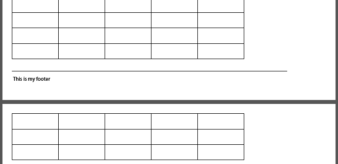

I added a header and footer in the Master page. The footer is outside of the content area and I selected the "Allow Page Breaks within content" button but still have not had any luck getting the table to flow to the next page without going over the footer. This is what I get when I try to add rows.

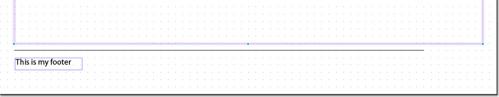

Also I have the footer outside of the content area as shown in the image below.footer area.PNG

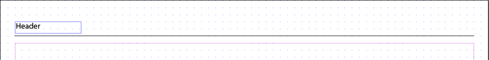

  4. Adjust the Content area size and make header and footer

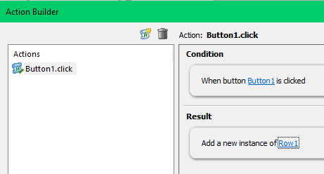

  7. In the Action Builder for the button, add an action to Add a new instance of Row1.
