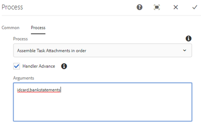

EDIT - testing workflowuser's process:
The following is the dynamic table with file attachments. The ordering is PDFs 1,2,3,4, but the resultant PDF from the process gives ordering 2,3,4,1.

I have changed the arguments, and i still get the issue. It works when there are 18 attachment elements, but not when there are more.
The same problem happens in the repeating bankstatements panel. It works when there are less than 20 attachments

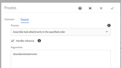

I have increased the size of my query to 100
Your workflow step should look like this
Hi workflowuser, I tested the new bundle and there are no issues with 20+ attachments. Thank you!
