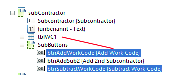

I have a form that has 30 sections in it and in each section is a table that allows addition of a work code.  Along with the 'Add' button there is a 'Remove' button in case a work code is entered in error.  In the very first section this button works correctly, removing the last work code entered.  In all the other sections, subContract2 thru subContract30 the 'Remove' button does not work.  I thought I had it coded correctly but I'm apparently missing something.  Can someone review and identify the issue?  TIA.
to be honest: You coding isn't great but overcomplicated. Why do you use the this.resolveNode() method? It's lazy and not needed when the elements in the hierarchy (subforms, fields etc.) are named well.You just have to image the location to the object that executes the script relative to the objects to be took into account by this. For example: tblWC1 and the buttons are very close together, just one level apart.
Instead of using resolveNode starting at the button (this) to then reference to the its parent parent "subContractor" and then refer to the instanceManagager (_) of its child element (tblWC1)
this.resolveNode('subContractor._tblWC1').addInstance(1);

_tblWC1.addInstance(true);
The some for the remove button. Use the shortest possible script.
_tblWC1.removeInstance(_tblWC1.count - 1);

The problem with the Subtract Work Code not working in the second instance of a Subcontractor is that  your code is not set to look at the last instance of our RepeatingRow2 table row. Try the first part of the code in the button this way:
var trRepCount = subContractor2.tblWC2.RepeatingRow2.instanceManager.count;
subContractor2.tblWC2._RepeatingRow2.removeInstance(trRepCount - 1);

As for the suggestion of the using the shortest possible reference seems to have done the trick.  Thank you.
