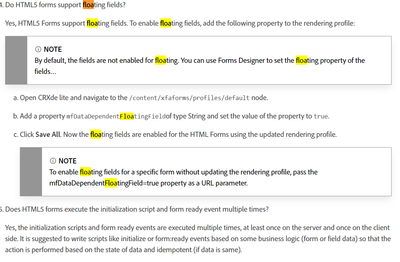

to enable floating fields support in html5 renditon of xdp ,please follow the following steps
9 Replies

you need to enable floating fields support in html5 rendition of xdp . https://experienceleague.adobe.com/docs/experience-manager-65/forms/html5-forms/faq.html?lang=en
@pranaym48551345  Please follow the steps as @workflowuser pointed out. If the issue persist kindly share a test form with us.

We are upgraded to AEM Forms latest patch and I found that floating field issue. Floating field value is displaying in PDF whereas in HTML5 value is coming as null. I have added the mfDataDependentFloatingField proprty as well but no luck.
