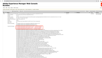

Imported Packages error after Adding the AEM forms core components
Followed this link to enable the form core components:
https://experienceleague.adobe.com/docs/experience-manager-cloud-service/content/forms/setup-configu...

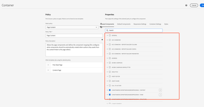

After getting the issue  and the page don't have adaptive forms component
Best regards!

Can you please check if you are missing the mentioned bundle in your AEM instance or using the old version incompatible with the code? Please verify the bundle and update the version or code accordingly as per your environment.
@krist_wang
The bundle count seems pretty low, and the missing dependencies (from the screenshot) are provided by the Adaptive Forms Core API bundle (com.adobe.aemds.guide.aemds-guide-core).
This bundle dependency is supplied by the Forms archive (aem-forms-sdk-cloud-ready_xxxx) for cloud so check if the local cloud dev instance has FAR installed.

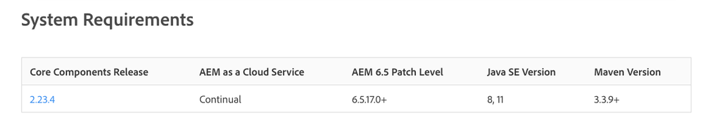

You are following the guide for AEMaaCS, where all the dependencies are there by default, but if you are using AEM on-premise (which is your case) you need to make sure you have the system requirements specified in the official documentation, please use the below links to know more about it:
https://experienceleague.adobe.com/docs/experience-manager-core-components/using/get-started/using.h...
 https://experienceleague.adobe.com/docs/experience-manager-core-components/using/introduction.html?l...
