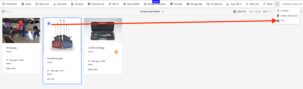

I finally have a solution that works.
I've implemented a FTP client with Java IO. Then i added a new quick action button on the Asset Details action bar, so the user is able to select an asset or multiple assets and send them to the FTP server.
When the user clicks the ftp button, a new Sling job is created, the sling job uses the FTP Client to send the assets to the FTP server and at the end sends a notification to the user.
