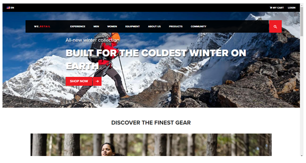

I am facing this issues in AEM 6.5 only. You can compare the headers before and after login.
After Login:
Before Login:
