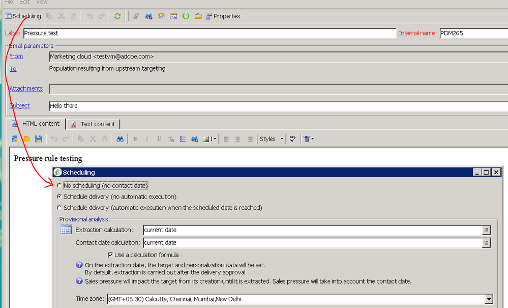

Probably you will have to do something like this to overcome the contact date limitation on the recurring delivery.
So the contact date will always be populated using the current timestamp.
I tested using this setup and got the pressure rules applied in the logs :

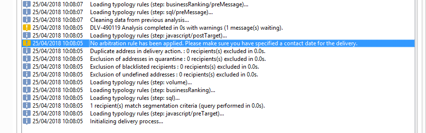

Hi Adhiyan and thanks for your reply.
Unfortunately, the results I am getting is the same as before. Please have a look at the audit below and you will see that the typology rule is not applied because of the lack f a contact date. Any idea of how to force that date to be set?
