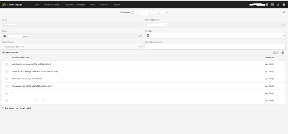

If you watch at the first screen capture, some rights are assigned in ACS interface

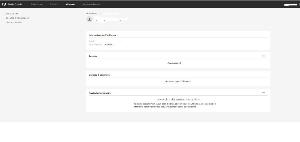

and when we look on the administration console, we couldn't find them (screen 2)

If I talked about group, the first screenshot show that the account is in the native group Workflow supervisor.
In the second screenshot, i can't find the link between the account and the group (it should be in the "groupe d'utilisateur" part).
So if i want to remove that account from the group, i just can't right now.

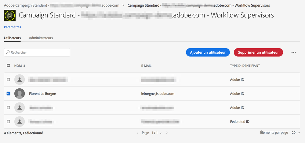

In my Adobe Campaign instance, I'm one of the workflow supervisors:
If I want to remove myself from that group, I can do it by going to the adminconsole, find the correct group in the list, and then remove myself from the group (not actually doing it since I like to supervise workflows )
Then it will sync with ACS and I will be removed from the group.
What surprises me is that you see nothing in the users detail from the adminconsole. You should have all the groups listed under the Products menu as well.
If that's not the case, I'd recommend getting in touch with support, as it should be synced as I just showed in my screenshots.
Florent

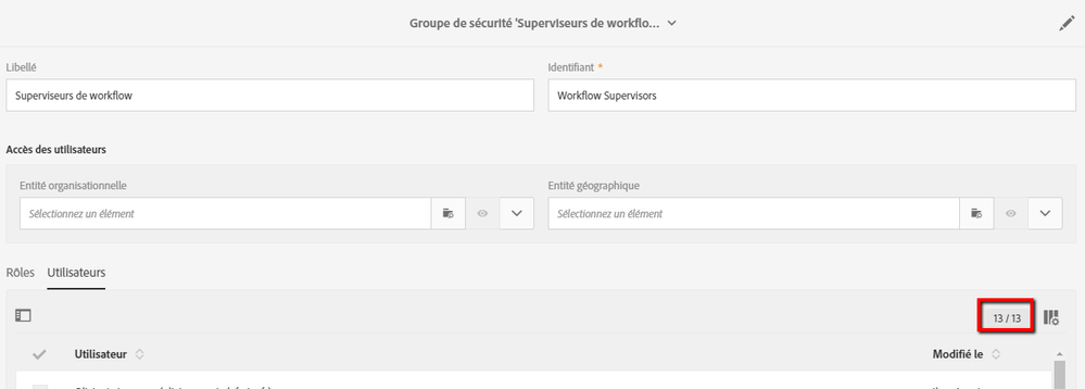

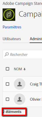

     if i look at the ACS security group workflow supervisor , i see 13 users:
when i connect on the adminconsole i only got 9 users and 2 administrator, so seems the synchronisation is not working as it should:
As for now I got no way to really work on group and users which can be a big issue.
