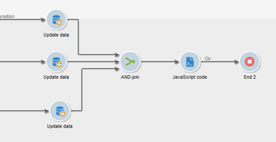

Step-2:
In 1st ETL Workflow as you're updating 3 schemas in it, connect the 3 update data activity's transition to 'AND join' activity, followed by a JavaScript code activity.
(In 'AND-Join' select any of the transition as primary set)
Step-3:
In JavaScript activity, trigger the 2nd WKF using xtk.workflow.PostEvent method
Syntax:
xtk.workflow.PostEvent("internalName_of_next_Workflow", "internalName_of_next_Workflow's_Signal_Activity", "", <variables/>, false);
//Example: if the 2nd ETL WKF's internal name is 'ETL_WKF2' then,
xtk.workflow.PostEvent("ETL_WKF2", "signal", "", <variables/>, false);

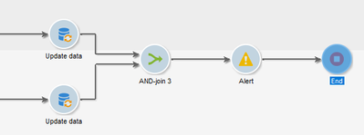

Step-5:
In the last ETL Workflow, instead of JavaScript activity, use 'Alert' activity, and configure the message as 'ALL ETL Workflows Ran successfully'.
So now you will be receiving a Unified alert message.

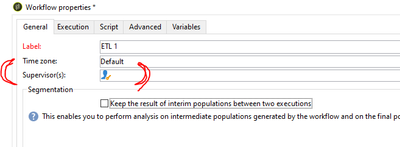

2. In all workflow's property  > General tab > select a 'Supervisor' group to get alert if any Workflow fails.
