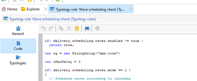

Wave Scheduling Typology Rules for sample of syntax
