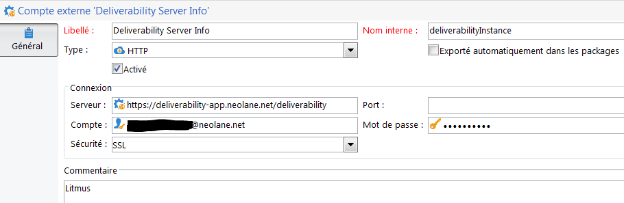

Of course, if you are facing an access denied, please check with Adobe team your credentials to use (login and password) and please enter it again in the Deliverability connector.
So go into the Administration>Platform>External Accounts and select the Deliverability connector:
