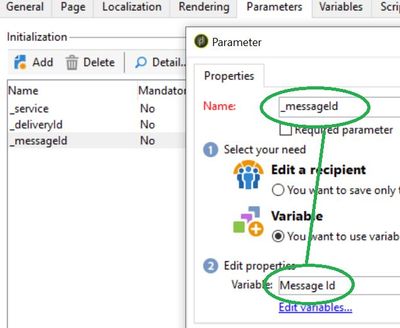

We are implementing a 'One-Click Unsubscription' feature in Adobe Campaign Classic. So far, we have successfully customized the out-of-the-box web app provided by Adobe to handle unsubscriptions and track them programmatically.
Our next challenge is identifying which delivery was used by a recipient to unsubscribe. Specifically, we want the web app to retrieve the delivery code associated with the recipient's unsubscription click. This would allow us to track the types of deliveries prompting unsubscriptions and manage service-level unsubscriptions more effectively.
We want to:
Is there a straightforward way to include the delivery code in the web app's context or fetch it programmatically? Are there best practices for handling delivery-level unsubscriptions to make this process more efficient?
Any guidance or examples on better handling and tracking of One Click Unsubscription would be greatly appreciated!
Solved! Go to Solution.
What you'd like to do is relatively easy to achieve. Be aware the post is a bit long as there are several steps to implement.
Also, the solution that will be described below is applicable if the unsubscription page is hosted by Adobe Campaign and is considered as a customisation of your Adobe Campaign solution as such, you will be responsible for its maintenance, etc...

Hope this helps,
Denis.
One way could be to include the delivery id in the unsubscription link parameters and use it in the web app to read delivery code.
You can refer to delivery id with <%= delivery.id %>

Hi @costa_n11 ,
Thank you for the detailed solution; it has been very effective for us. However, we are still encountering an issue in the test environment as solution is implemented in Test only for now. When clicking the unsubscribe button in the email, it does not function as expected and does not correctly address the web application. However, when we copy the URL from the "Show Original" option in the browser and manually unsubscribe the recipient, it works correctly, and the tracking logs are generated as expected.
What could be the possible reason for this behavior? Could this be specific to the test environment? Your assistance in resolving this issue would be greatly appreciated.
