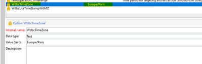

Please do the following check:
Case1: If this is new issue, Please check value of following option.
1. Check the time zone in the WdbcTimeZone option.
is it same as your time zone? There we set the time zone for the SQL DB.
If it is not same then you get the different time.
2. Check the value of WdbcUseTimeStampWithTZ option: It should be 1, to activate the time zone which is mentioned in point 1.
Note: if these option was changed and data is store in DB with incorrect + GMT value, it would not be correct after update of these option. Correction will be applicable for new data. Please check it, because it can happen.

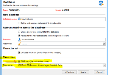

Case 2: After New Installation.
I think you forgot to select the correct time zone and GMT option during installation.
If possible you can try this step again and select these value.
