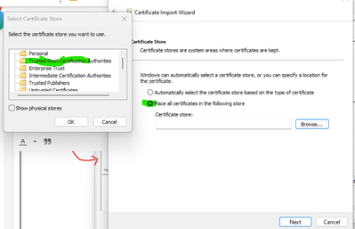

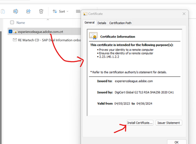

From the description I understood it is certificate validation issue. So I opened the URL using browser "https://<my url>/nl/jsp/install.jsp" and downloaded the public certificate. Then I exported the full chain of certificate. I am sharing a sample screenshot below from adobe's SSL certificate. It has 2 root certs with one end certificate. Now you have to install all of those 3 in your trusted root certificate. It might be okay to install the end level certificate outside root, but I installed all into root to be safe and didn't try installing outside.
Note: Make sure you trust the certificate before adding to root. For me it was a cert created by my organization and so no question of trust.
Double click on saved public cert and install it
I placed it for the current user, if you have higher access you can place it into the machine specific CA store also I think
