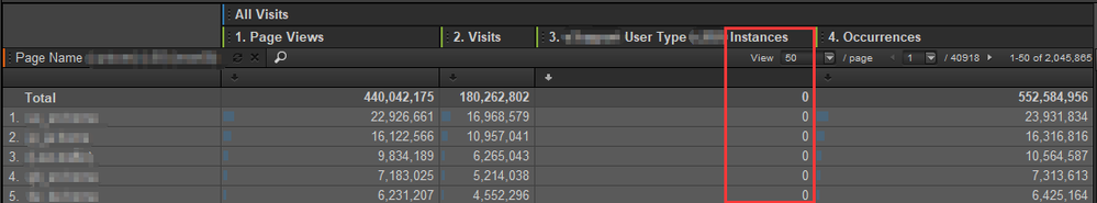

I don't wish to jump to the conclusion that the tag is not well implemented.
But perhaps it is being triggered on a different page, because that is the only page where User Tpe = Premium is available.
Then, thanks to the persistence of eVars (and this is highly dependent on how the eVar is configured) the 'Premium' value follows you around, so that you can run a report showing the number of Premium users logged in.
But like Arun said, User Type may also be set via other methods, such as Processing Rules, Data Sources, Vista Rules, or even Classifications. You could ask your architect for this information, or failing that, the original Solution Design (Plan B).
Plan C would be to find out if your analytics account has Web API access so you could try to produce your own Solution Design using the excellent ObservePoint Labs - G Suite Marketplace addon for Google Sheets.
Failing that, you could open the Search panel in Chrome Developer tools and look for 'evar101'

I just followed the first of your reply, 0 is the only result.
I think I have to try the plan B and C ...

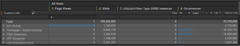

jorisdebeer,
The Plan C DOES HELPFUL!!!
I can find
Which is not displayed in debugger.
I guess that's one of the way Arun mentioned to fire to AA.
Million Thanks.
