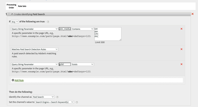

Here is the current screenshot of the paid search rules as they rely on query string parameters.
However, i'm still seeing that organic search shows page with utm parameters when i tried to filter for page with query parameters. This is the part where it doesn't make sense to me as the rules look for query parameters with utm_medium=cpc. Screenshot 2025-04-22 at 7.25.58 PM.png
