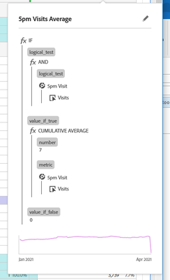

Hi There,
I have managed to solve this for you.
The first thing you need is a "5pm Visit" such as below:
Then you need the following:
Change Number "7" for the period you want to look back.
So if your report is showing days, it will be 7 days, if it is weeks it will be 7 weeks.
I hope that helps.
Dave

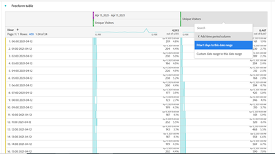

@deion If I am right than you want to compare the data from the previous day on hourly basis. To achieve this you can right click on metric name in Workspace project -> Click on Add Time Period column -> click on Prior date range to this date range. Than use the hour dimension to compare the data on hourly basis with previous date.
Refer the below screenshot :-

Hi There,
I hope that helps.
Dave
