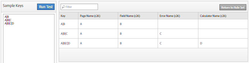

Dear Panangipallik36,
Possible. We do have an eVar which will capture PageName|FieldName|ErrorName|CalculatorName but it can be PageName|FieldName or PageName|FieldName|ErrorName or PageName|FieldName|ErrorName|CalculatorName. So we have classified it based on its hierarchy: Below the screen grab and its results. Use it!
Rule & Order:
Results:
Thank You, Arun.
