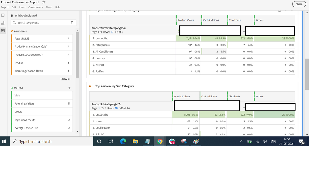

Hi Team,
All the orders data is coming under unspecified for eVar16 and eVar17. Both these eVars are not merchandising evars  , it have allocation of original value(first) and expires after the visit. Please find the reference image and let me know the cause for the same.

@yuhuisg, No because when I breakdown it with URL it contain the URLs which has evar16 and evar17, but In purchase rule evar 16 and evar 17 is not set, but here issue is most of prodview is coming maximum under unspecified. Is it possible?
If I edit the purchase rule, do you think it will work?
@yuhuisg, Is my thought process is right.
Could it be that eVars 16 and 17 are not being set properly on those pages then?
@yuhuisg, but why prodview is high, I can't understand the reason. Can you help me with that.
prodView gets tracked every time you track a s.products string without any shopping cart events. See https://experienceleague.adobe.com/docs/analytics/components/metrics/product-views.html?lang=en
