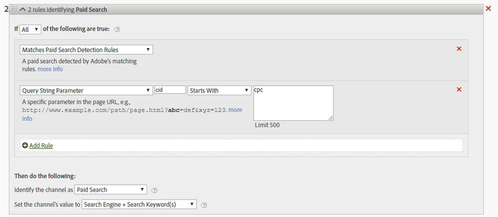

I have come an across issue with the Marketing Channels where Paid Search in Workspace report was showing among other correct values (as defined in the Marketing Channel rules) also the "None" value and I just can't see why. I am pretty new to Adobe Analytics so it is very likely that I am missing something out.
Here is my Paid Search rule:
The query string parameters all begin with cid followed by the channel identification code. In case of paid search it is cid=cpc. (social is cid=social etc.) so I have set up the Paid Search detection rules like this  (search engine "any" and query string contains cid=cpc and other containing just cpc - don't know what is the proper syntax, but I suppose these should both work):
