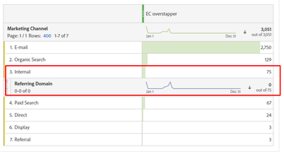

I have a list of sister websites from our main website. If I look at the Marketing Channels I can't see the Referrer Domains if I use for instance Marketing Channel Detail or Referring Domain.
www.consumentenbond.nl is our main website and I want to see how many visitors were from our sister website www.klachtenkompas.nl when they converted. What dimension do I use to see the referrers within Internal in Workspace?

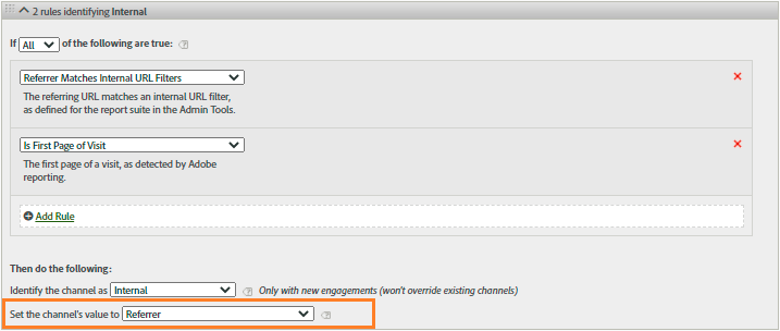

Dear Livakster,
Check the Marketing Channel Detail value highlighted. If it not set to 'Referrer', kindly change it to 'Referrer' in Marketing Channel Processing Rules.
Also, make sure that you are not overriding referrer values manually on the pages i.e. Implementation.
Thank You, Pratheep Arun Raj B | Xerago | Terryn Winter Analytics

To make it more clear what my problem is.
- www.consumentenbond.nl is our main website
- These are examples of our sister websites: www.klachtenkompas.nl, community.consumentenbond.nl, ebikecollectief.consumentenbond.nl
- I have listed these and many others to the Internal URL Filters. So that these will be seen as 'Internal' by Adobe Analytics if I use Marketing Channel.
- However, I still would like to see the visitors from which sister website were responsible for the conversion.
See screenshot below of how I see it in Workspace:
Dear Livakster,
Hello PratheepArunRaj, I have finally get it to work. Thanks for your suggestion. I only need to make it work that I see our subdomains in Marketing Channel Internal. My main website is www.consumentenbond.nl and our sister websites are now showing in the reports (www.klachtenkompas.nl, www.claimservice.nl), but not https://cvketelcollectief.consumentenbond.nl for example. Do you have an idea how I can do this?
