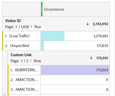

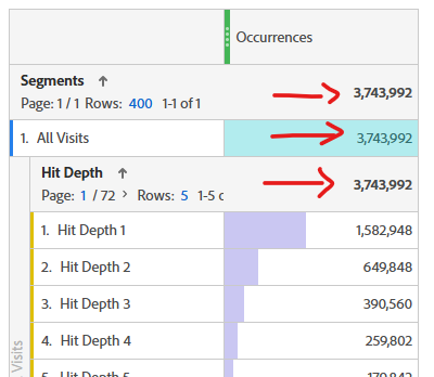

I am not talking about only seeing the first 5 rows... that first column showing occurrences, the total "unspecified" shows a total of 15,645... only 8,852 of those have a hit depth...  that means almost 7K occurrences have no hit depth at all....
All occurrences should have a hit depth:
You can see that the "total", matches the All Visits Total, Matches the Hit Depth Total.
Or, if I replicate your setup, looking at Unspecified ECID, the total unspecified matches the total Hit Depth:
In my case, I can see that most of my unspecified are coming from my Mobile App Lifecycle (which is expected, since we can't modify the Lifecycle metric to include dimensions), and I know that there is a small possibility in our apps for the ECID to fail which accounts for the remainder:
However, you have so many hits with no hit depth is something I really think you need to investigate... as that is not normal behaviour.
