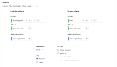

Honestly, I would be more tempted to use a Cohort Table for this (https://experienceleague.adobe.com/en/docs/analytics/analyze/analysis-workspace/visualizations/cohor...😞
You can change the granularity, it doesn't have to be "months"...
Rolling Calculation is for when you want to check return rate only for people that come back in every column...
For instance.
Initial - watched a live stream (now they are in the "included" column for the time frame
+1 Month - visitor returned
+2 Months - visitor returned
+3 Months - visitor did not return
+4 Months - visitor returned
If no "rolling calculation", then this user will show in the included column, then in columns for +1 Month, +2 Months and +4 Months
If "rolling calculation" is selected, then this user will be in the included column, then only +1 Month and +2 Months... because they did not coming in +3 Months (they are dropped from the cohort because their returns weren't concurrent.
You can create segments from cohort cells, but those tend to have "baked in date ranges".

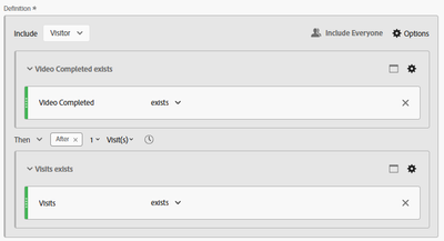

A simple segment would just be:
This should look for Visitors who watched a video, then after 1 visit returned to the site (this is to fulfil the "came back to the site and not part of the same visit" logic)

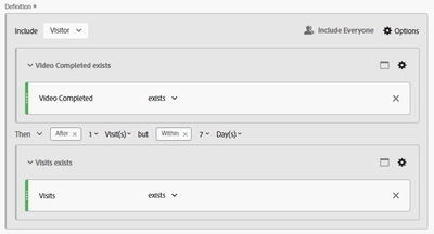

If you want to add constraints, like the user had to have returned, but within 7 days (i.e. the site is still "fresh" in their mind), then you could use something like:
The time frames you use are really up to you.. there is no "standard"...  what are you trying see really?

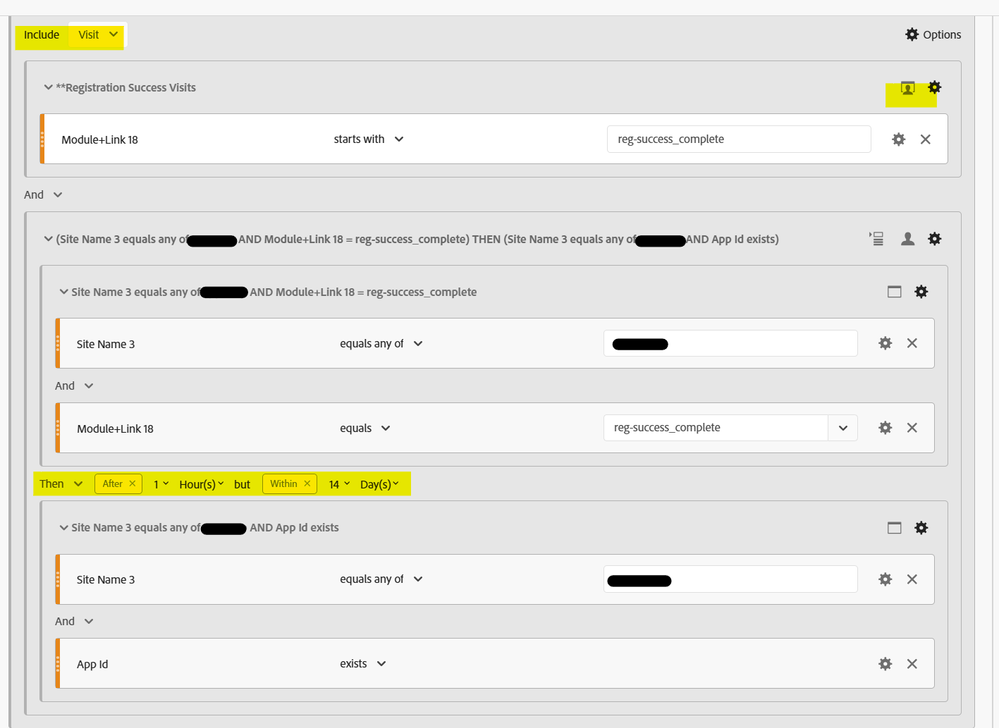

So, I further refined the logic using nested segments:
Final Segment Logic:
  • Segment scope: visit
{ Segment scope as Visits:
[VISIT with registration event on app]
AND
{ Include everyone, Segment scope as visitor:
THEN WITH IN 15 DAYS AFTER 45 MIN(S)
[VISIT with PageView>=1 on app] }
This ensures we only include the registration visit of users who returned within the 15-day window.
Here is how my final segment looks like:
Thoughts & Caveats
This workaround worked for me because it's rare for users to register multiple times. However, in your case—where users might complete a video in multiple months—this logic could result in overcounting.
For example:
  • User A watches a video in January and returns within 7 days → counted
  • The same user watches another video in February but does not return → still counted in February
So this segment logic captures return behavior at the user level, not tied strictly to each video completion. This means the user appears in all months they completed a video, even if they didn’t return afterward in some of them.
