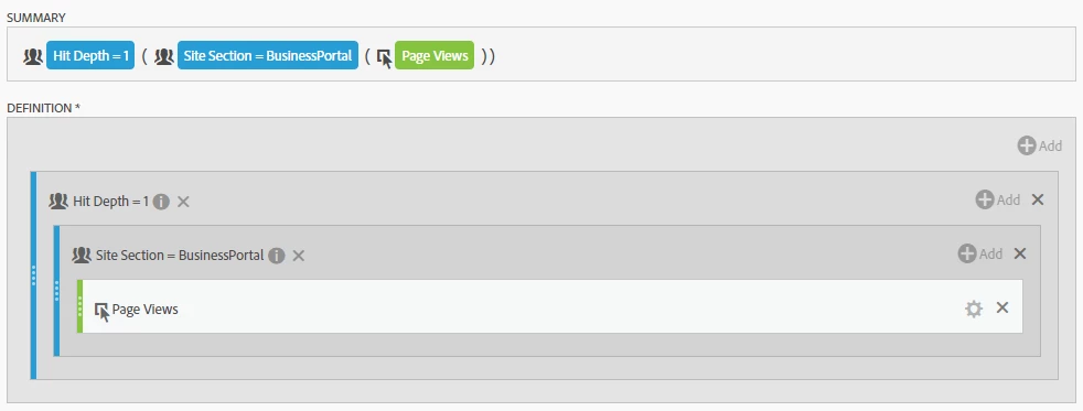

Best answer by PratheepArunRaj
Dear Sai,
You need to use 'Hit Depth'. Check out Hit Depth!
Something like below will help to solve the query.
Thank You!
Arun
PratheepArunRaj
PratheepArunRajCommunity Advisor and Adobe ChampionAccepted solution
March 28, 2019
Dear Sai,
Thank You!
Arun

Hello Arun,
Thank you for you response.
I think your solution gives the hits where site section = BusinessPortal, only when the hit is the first hit in the visit (hit depth=1).
