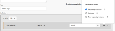

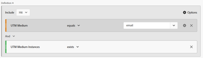

I have tried in the past to build a segment for a page where an evar was set (and not for a page where an evar persisted from a previous page and therefore sill existed)?
So my segment was a hit container where evarXYZ existed.
However, based on the results, it seems to me that it was showing me all hits where the evar was either set on the page OR all hits where the evar was present because it persisted from a previous page..
Would using the evar instance metric be a solution to isole hits where an evar was set? (hit container where evarXYZ instances exists)
This is exactly right! There are two ways to do this... you can leverage the Instance Metric directly:
Or, you can use the gear on your eVar to set behaviours:
Repeating is the default, this means it will return all the hits where the eVar equals the value (whether explicitly set, or persisted)
Instance will only return the hits where the value was explicitly set (i.e. eVar10="x")
Non-Repeating Instance is interesting, it will return the instances of where the value was set, unless the same value was set in a row, it will exclude the repeats.... for example:
