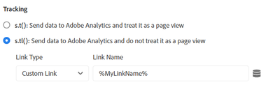

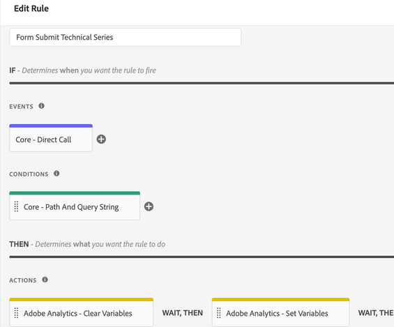

I have a "Marketo form" enabled on various site pages. I even successfully track the form submissions using the "Direct Call" Rule via launch to report in Adobe Analytics. However, for one specific page with the same Marketo Form, I want to create a separate rule in Adobe Launch to map some specific eVars for some purpose. So, I was wondering can I add the condition to the rule as per the below screenshots so that when a form gets submitted on that specific page then those specific eVars that I want to map can also get triggered. Is this is okay?
NOTE: in the existing rule for tracking marketo form submits the direct call trigger happens only when a successful form submission happens and then adobe launch performs the further actions.
For example: If a specific page to which I want to add a set of eVars looks like
https://www.qwe.com/about-us/events/technical-series
Hi @JyotiSharmaV
Path and query string should only return what's in the URL after the domain
e.g., in your example  /about-us/events/technical-series
or, should you have query params, /about-us/events/technical-series?someparam=somevalue
So yes, you can create a separate rule that does some additional tracking with other eVars, props, etc set.
You may want to exlcude these specific pages from the other rule though unless you want to send a second tracking call.
Cheers from Switzerland!

Yep, I was just about to say that you need a condition on the original rule so that only one of the rules will trigger.. and that the "path" only looks at the path and not the full URL.
However, if I had this need, I would actually do my implementation differently....
An alternate option is to create some custom code Data Elements, that set a value IF the page is X, or just be empty ("") if it's not, then add those dimensions to the existing rule....
This way you have one rule, and the values you need for that one specific page / use will populate only when needed.
In Adobe, not including a dimension is the exact same as setting a dimension to an empty value... and the AppMeasurement.js won't include the dimension in the beacon if it's empty (so you don't even have to worry about it being there if there is no value).

Hi @JyotiSharmaV ,
Though you can achieve this in many ways I'd choose to use the existing form submit rule with another custom code action added to it for populating the eVars you need on the specific page.
This custom code action can be populated as below,
if (window.document.location.href.split("?")[0] === "https://www.qwe.com/about-us/events/technical-series"){
	//populate needed eVars using respective data elements or directly from page through JS
	s.eVarX = [eVarX value];
	s.eVarY = [eVarY value];
	//add above populated eVars to linkTrackVars to track them on s.tl() calls
	s.linkTrackVars = s.apl(s.linkTrackVars, eVarX, eVarY);
Using this approach can be preferred because of below,
  • You get to keep the single rule for your generic and custom form tracking needs
  • Using the custom code you have more granular control on when and how to set each variable which means you can add more conditions or nest them
  • As you are setting all the variable in one place it gives you benefits like,
    • Define the conditional logic only once (unlike defining it again and again if you choose to create custom code data elements for each variable) helps in keeping the library size lighter
    • Having the custom code in one place makes it easier to update/debug when needed
  • You can order the rule actions as needed, e.g. incase override some variable values set through generic form submit set variables action with values set through custom code set variables actions and vice-a-versa
