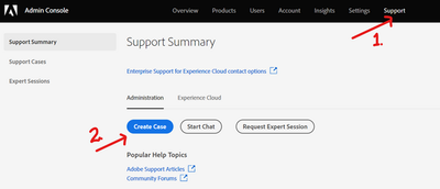

If you need help creating a ticked, @nilotpal posted the steps a few days ago. Pasting the info here:
You can raise a client care ticket through Admin Console provided you have Support Admin right in your Organization.
This can be done by logging in to Admin Console, Go to Support and Create a Case.
Alternatively, you can ask the Support Admin in your Org to log a ticket on your behalf and add you as a watcher.
You can also call on Adobe Support phone number and request help: https://helpx.adobe.com/entp/enterprise-phone-numbers.html.
Hope this is helpful.
