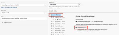

For example, you created a rule for video starts. In the same rule you would typically create an update variable and send event actions. After these two actions, you need to add one action using update variable action and configure it as shown
Add another action > Click on the xdm > enable the Clear Existing value.
Once you complete this, you will not see the event50 in the Video finished Event.
I hope it will help, let me know if you need further assistance on this.
Good Luck.
I think the above attached screenshot is not clear, refer to the below screenshot for clear one

You've already got some good answers here, but to answer the above. The reason checking that box doesn't clear it is because you are clearing an existing value for event54, which of course is not there. If you'd set event54 on a previous hit, then it would be cleared.
What I think you can also do, althought it's a while since I've done it, is select event50, set it to 0, and select the 'Clear existing value' checkbox. I think that used to work for me.
