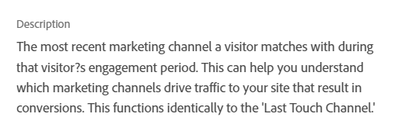

If you are looking at Adobe Data Warehouse, then you should look for Last Touch Channel and Last Touch Channel Detail (Marketing Channel and Last Touch Channel return the same results in Workspace)
So, in Data Warehouse you can use Last Touch to get the same data:
