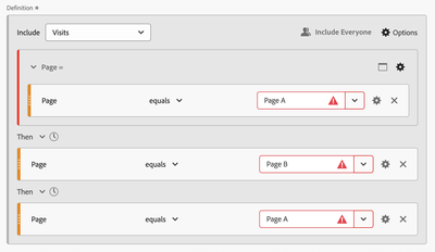

for your A > B case, maybe try something like this
and B > A
And if you need an immediate page view chain, you could limit the "THEN" condition to "WITHIN 1 Page View"

OK, so @bjoern__koth's sample needs a little tweaking... you will have to add "Within 1 Page" to clarify those THEN operators.
THEN is any time in the visit, so long as the order is met
THEN WITHIN X [hit/page view/etc] must be within the specified criteria
This should get you closer to your needs, but otherwise, the structure that Bjorn provided should be good... but test, test, test, lol
And I just saw that Bjorn did add that at the end... lol.. this is what happens when you are multi-tasking.

The other thing that might be happening is that you might have
A > B > C > D > B > A
So this flow would appear in both segments, and since the A > B > A isn't directly in line with one another, it doesn't meet the exclusion criteria...
Sometimes the sequential segments aren't the easiest to get the full granularity of your needs...
